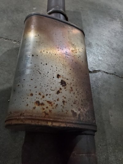

I do have an UPDATE on the CGS system. It's been a few months and the system is starting to show a lot of signs of rust already. The "Stainless tip and stainless muffler" as advertised, are covered in rust badly. I checked and they are magnetic too, which means it's not stainless. I won't even bother complaining because I'll probably get nowhere with the company and even if they sent me a new muffler it'll do the same thing in 4 months. The non-stainless pipes look ok so far, not covered in rusty pits like the muffler and tip. I'll have to keep my eye out for a different brand muffler and tip to bolt on in the future.

I ended up getting the CGS system which was actually in stock, less expensive, and took less than a week to get delivered. However the CGS system is NOT stainless as advertised. The CGS system "stainless" muffler and tip are corroding horribly bad. They look like they're about to have holes in them any day now and they're only 4 months old. I'm not happy with that at all. My next step will be to try either Magnaflow or Borla's stainless muffler and tip to see how they do in the weather.

I finally gave up on the CGS muffler after trying to make it sound the way I want for months. I had installed an Auger type resonator inside the pipe but it kept coming loose and rattling. The CGS muffler was also corroding very badly. The most annoying part of the system was the horrible drone at 1800-2200 rpm range. I just replaced the muffler itself with a Walker sound FX muffler part number 17809. It's 10" longer so I had to cut a piece off the inlet pipe on the truck. Now the truck sounds great on the outside- still sounds louder than stock, but from inside the cab it's extremely quiet, even with the windows open. There's no more drone at all. I also replaced the crappy CGS exhaust clamps that originally came with their system. I put in stainless steel ones from Evil Eye. These new ones seem to really grip the pipes much better and they're not rotating anymore.
The Walker muffler is not stainless though, it's aluminized so I'll probably get corrosion eventually since we go to the boat ramp every week. But this aluminized coating is better than the bare metal on the CGS muffler. The factory muffler was aluminized too and it lasted 14 years, and I only really changed it because it was too quiet.
Here's what the CGS muffler looks like after 6 months/ more or less
