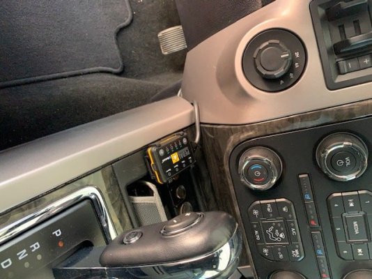

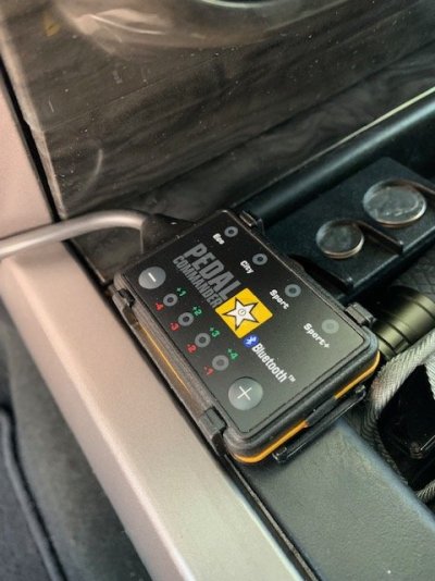

02/21/2023 Update 2: Pedal Commander arrived. Counting the time I took carefully removing the product out of the box and installing it I say maybe 4 minutes lapsed. The the road test. The unit defaults to Sport+ but I changed it to City mode setting enhancement to 3 (previously had one in my 4Runner and know that Sport+ mode is ridiculous. There are 4 modes: Eco (which is worse that stock and almost dangerously sluggish), City mode, Sport mode and then Sport+ mode. The road test was in City mode. By the time I backed into the street I knew I had a new animal under the hood. Throttle response is immediate. It literally feels like I just added 200hp and yet these devices don't add 1 iota of horsepower but gives you the sensation that you got a new tiger under the hood. Those of us that spend the (really) big bucks for performance mods do it for the sensation of power - this gives you that sensation without crazy modifications to your power plant. There are competitors out there that claim they were the first to market with such a device and they are 10-20 dollars cheaper but, they are really chincy looking and for us older guys their small digital readout is a little difficult to see. These units seem to be built very well using a heavy duty cable vs the competitor unit. Here's a couple pictures of the installation:
It is a $300 bill but you'll forget that the first time you drive it...
