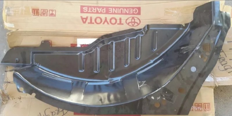

Another component I’d like to replace is the wheel housing panel (part number AL1Z-7827865-A), but I’m unsure how it is attached from the factory.
Since I still have some time before starting the project, I’m currently gathering parts and information. Photos of the floor pan and wheel housing area would be extremely helpful. So far, I’ve only found one image, but the plastic covers hide most of the wheel housing, making it difficult to see how it ties into the body structure.

Wheel housing I'm planning to replace (AL1Z-7827865-A):
Looking for the photos of this area without plastic covers. Any other floor pan, rocker panels photos will be appreciated.

I can't recall seeing a thread or pics of someone replacing the wheel tub. Good luck finding that. I can tell you a good bit of it is secured with spot welds, but I'm not sure if it is all that way.

Spot welds and seam sealer. You might consider a partial wheel tub replacement. The wheel tub might be one of the first parts installed during factory assembly. I do not have the collision repair manual for this vehicle.
