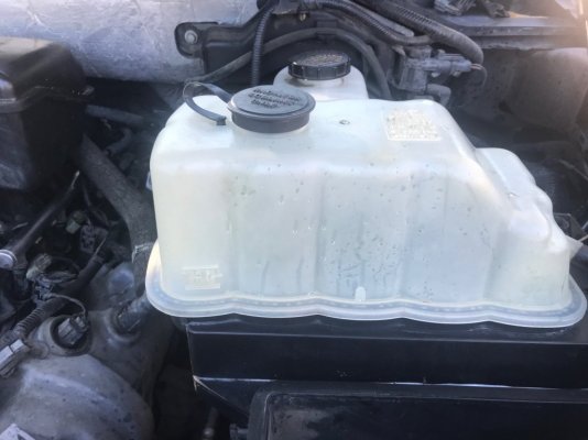

I noticed the expansion tank was pretty filthy and that always bothers me.

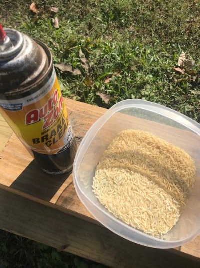

I did find an idea on YT using brake cleaner and rice so i thought i'd try it.

What irritates me is you can hardly see the level properly and having that junk sucked into the cooling system can't be a good thing.
Using a funnel put the rice and spray a good bit of brake cleaner into the tank.
THEN SHAKE !!!!
i flushed out the rice which was now brown/black with the hose and repeated ... in all
i probably did about 5 mins shaking ...
Not a lot really and quickly i saw the tank coming nice and clean.
Detailed the fill instructions with a paint pen and highlighted the 'ORANGE' on the top of the tank too
