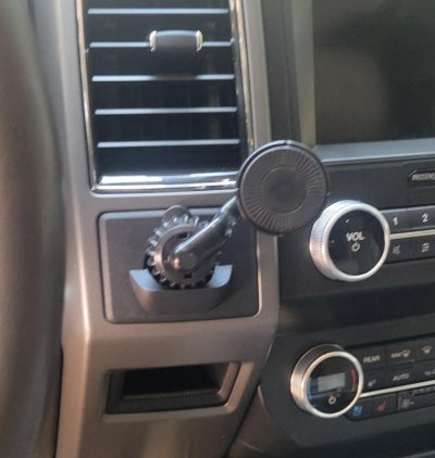

Just got a '21, and hate having my phone bounce around or get lost in the charging dungeon.

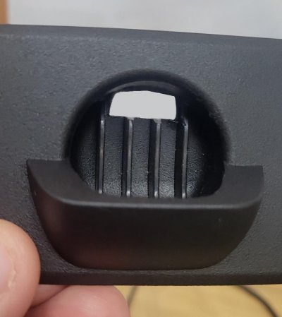

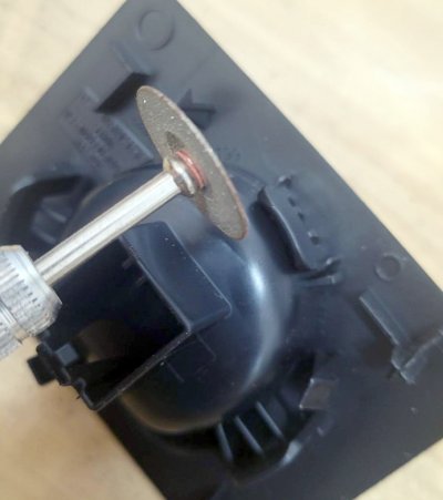

Here's my coin slot solution. I had an unused $5 vent mount (I hate them, they interfere with the air and eventually break the vent), at hand. Using a Dremel, I cut a small slot at the top of the coin holder. The vent grip "hook" goes through the slot and grips nicely on the ABS lip. Holds very tight, and it's adjustable for position/angle. I may eventually replace it with a charging pad, but it's unimportant right now. A standard cable will work if needed.
Took me about 10 minutes, but it's really a 5 minute job.
