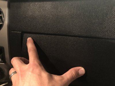

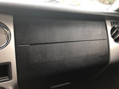

Pic I took on initial inspection of the vehicle from awhile back. The left side is the split kind of hard to see.
I’ll get a better pic when the wife gets home.

If you shine a light in the crack you can see the creme colored fabric of the airbag. Can’t tell how that portion may or may not be connected to the dash.

I just checked and mine is super soft and flexible. I know this is by design but even I was surprised at how soft and flimsy the panel appears on my 2015. Thanks for the heads up on this. I will not allow anyone in my passenger seat to mess with this or put their feet there. Yikes.

Looks like your dealer is going to be eating some freight cost shipping that big ole dashboard back to Ford. The good news is they'll have that airbag changed out in about an hour.

Dealer called after they started tearing apart the dash.
Those that were in the no whole dash camp were correct.
Just the airbag needs to be replaced. Which won’t be here until next week.

I didn’t think it would be different, the dash is largely the same throughout the 3rd gen, and the airbag looks exact. Glad it’s figured out!

Good. If not it would have went against my 20+ years of experience dealing with these as I have never seen or heard of such a thing before.
