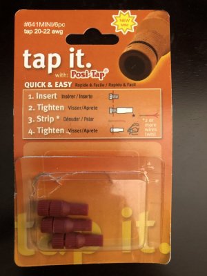

2.2. 3x wire taps. I used Posi-tap

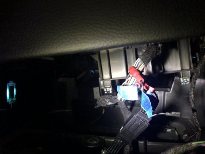

3.5. Carefully cut back or unwind the loom tape from around the gear shift module harness. I had disconnected the harness to get better access.
3.6. Find the following wires
3.6.1. Black w/ blue stripe - Ground
3.6.2. Brown w/ green stripe – Switch output
3.6.3. Brown w/ white stripe – +12v supply

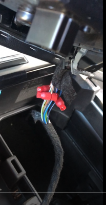

3.7. Install wire taps on these wires.
3.8. If you want to further verify that you have the correct wires, measure voltage.

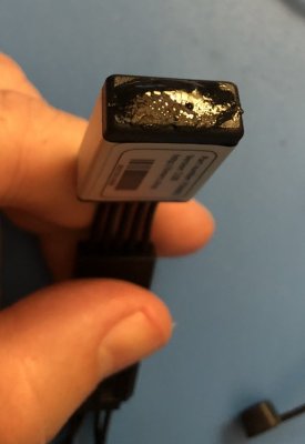

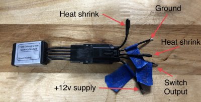

3.9. Cut the harness from one side of the memory module.
3.10. Paint a few layers of liquid electrical tap on the exposed wire leads.
3.11. Using the cut off memory module harness, heat shrink over the two unused wires.
3.12. Connect the harness to the wire taps according to the image. Ensure the orientation is the same as the picture.
3.13. Secure the memory module to the harness.
3.14. Plug everything back in
3.15. Re-connect the battery.
3.16. Start the truck. Change the setting. Shut off truck. Start truck again and verify the setting was remembered.
