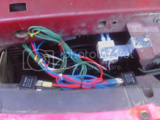

The thing you lose with the cheaper controllers (pretty much just a relay) is the soft start capability. It's either full on, or off. With other setups, it will start up slowly, increasing speed as needed. There were few times when my Mark VIII ran at full speed.
This also helps with the current draw.
