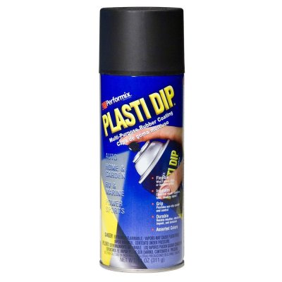

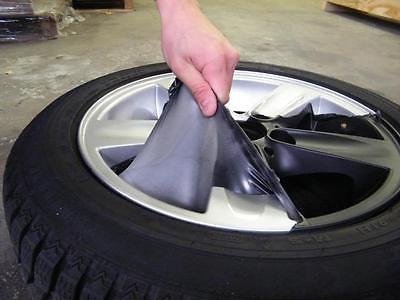

Btw chuck,
Do you realize how easy it is to use plasti-dip? The stuff is really amazing. I’ve used it several times for different applications and it works well. No drama trying to get your vinyl wrap to lay flat with no wrinkles, just tape off the area you want to apply, then spray the stuff down out of a can just like spray paint. Spray a good few layers so it’s laid nice and thick, remove your tape before it’s dry and you’re done. If you don’t like it, let it dry for a day and then simply peel it off. One can would do the trick and you’re all done. Seriously, try it. You’ll be surprised.
