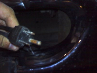

so i wouldnt have to worry about it if it snows when i stay in the mountains here. it can go to about the 10s. its not THAT cold compared to some parts of the country but i know ill be a girl for that weekend. haha i mean my expedition already came from the factory with the engine block heater so no wiring is needed. theres a plug in my bumper. ill take a pic later today to post. thats the only thing i can thing its used for. maybe a battery jumper? idk.

I'm sure it's a block heater. Follow the cord and it should lead to the block and dead end into a core plug. That is the most common style. Magnetic mats (on the oil pan), immersed oil and some that are plumbed into coolant hoses that "pump" (convection) heat are some other styles. I have seen and installed some that are spliced to power an onboard battery tender as well as a block heater. It was a bosses snow plow truck that he wanted to make sure would start when he arrived up at his cabin. The truck would go unused for months......

yeah it is uncommon. but i never put this in. and i dought the original owners would too. especially if it was a drug runner. i have done the built your car on ford.com and toyota.com and what not. and engine block heater is an option. but who knows. and i bet once i get my efans installed it will heat up quicker cause of the lack of a fan spinning when its cold. i need to follow the cable. idk what its for. theres also a cover for the plug. my hand was covering it.
sorry about the bad pic. it was night and it just sprinkled a little bit. and its in my bumper opening.
