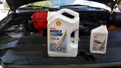

Hey guys so I had my mechanic look at it. He agreed that it was phaser noise. He recommended that I change the oil and substitute 1 quart of oil with a quart of tramny fluid to use as a detergent. Then he said to drive to 100 or 200 miles and change the oil again without tranny fluid. I've never heard of this before-would like a second opinion--is this safe? If so do you all have any recommendations of type of oil, tranny fluid and filter to use? Appreciated.

Yes this was recommended to me by an old friend, and retired Ford mechanic years back.You can use dextron/ mercon, about a half quart or so. You can also use marvel mystery oil, good stuff. Either one is fine, they work to unstick valve lifters, piston rings, helps remove varnish/ gunk buildup. Leave in for about 250-400 miles. Drive your SUV easy, drop oil and filter. Hopefully it helps.
