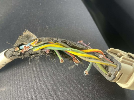

SHop found wood rat nests under the battery + fuse panel trays, and under the intake manifold. they found a handful of chomped wires including canbus to the engine control module, spliced them back, and its starting, yeah. they want to replace the main carpet as there's rodent debris under the back seats I never saw, as well as behind the side panels in the cargo bay, and urine stains in those areas.
