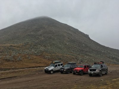

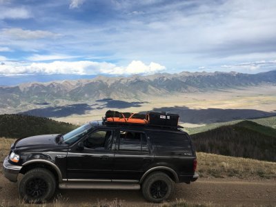

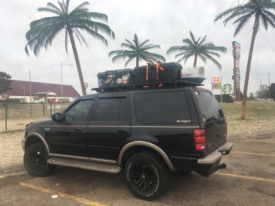

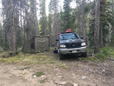

I used my 2000 Eddie Bauer for “overlanding” many times.
There’s a recent thread on Expedition Portal about this very subject. It seems that people that own domestics have been “car camping” for decades, long before there was a trendy term for it. But it doesn’t get the street cred that the Toyotas and Jeeps get. The thought is that domestics are bought by rednecks and lower income people while Toyotas and Jeeps are a more sophisticated buyer. As a result, the aftermarket is super poor for domestics.
But honestly, what do you really need to go car camping? My 2000 went the same places the 4Runners and Jeeps went- and they had fancy locking diffs and traction control and fancy suspension parts. I had my torsion bars turned up the max and coil spacers..... pretty much factory.
In my opinion, the best things for “overlanding”, regardless of vehicle, is interior and exterior storage. I had an Eezi-Awn platform rack on the roof and an ARB drawer in the back. Both are 100% universal. Beyond that, what more do you honestly need? Bumpers? You don’t “need” anything different than stock- Expeditions already have frame mounted tow points up front and a receiver in the rear. Lift? You don’t really “need” a lift- but I believe all generations have lifts available in some form or another. Sliders? Maybe. Talk to a local fabricator/welder. Probably cost you the same as buying some out of a catalog for a Jeep or 4Runner.

Thank you so much for the pics. That's a nice looking machine. And that's my old Expy. Loved that truck. Nearly invincible. I still prefer this body to any of the later ones.
Now, to be fair to the 4Runners and Jeeps, you also had fancy traction control and lockers in the 4A, 4H and 4L modes. In fact, I feel like the 4A mode was pretty advanced for when it was first introduced. Got me through a lot of snow.
And I can buy your explanation of vehicles having a reputation. Expys just don't seem to be well known. Better for us. But you can understand - Toyotas are sold all over the world. I mean, when the 100 series Land Cruiser went luxury, they also made a special 105 series for countries that still wanted a stripped down machine, they had so many markets to satisfy.
So, I'm curious about this torsion bar lift. No issues driving long distances with the CVs cambered liked that?

True, Toyotas are sold around the world, but domestics rule North America. I have a buddy with a Lexus 100-series. Finding parts for it isn’t super easy. And just how far are your “car camping” adventures going to take you? Be honest. Would you rather try to find parts for a 4Runner in some small town in Rural America or a vehicle based on the #1 vehicle in the world?
And I used the factory keys for the torsion bar lift. So “technically” I was still within factory specs. “Technically”. I live in CO and drove it to both coasts like that. I probably put close to 60k miles on it like that. Made the ride a little harsher, but not bad. Offroad flex was not very good, but it still got around fine on the trails.
