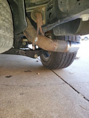

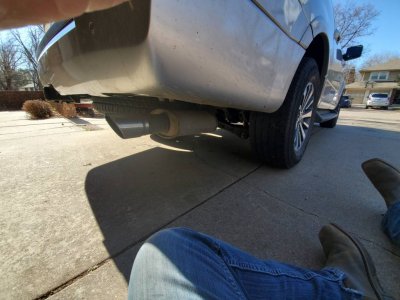

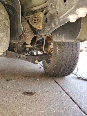

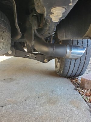

Free exhaust mod (resonator delete)
Millerwelds1
Jan 26, 2020
25
Derby, Ks

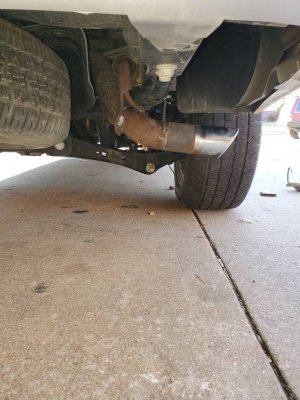

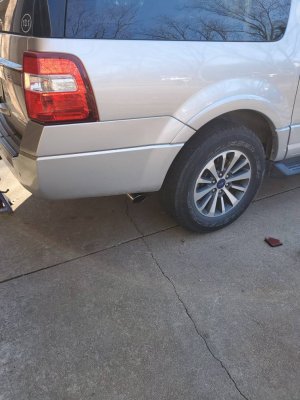

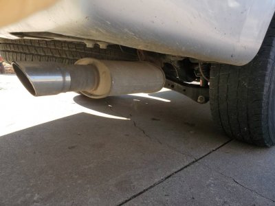

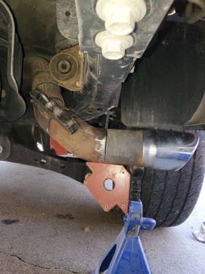

All the pipe used was from the exhaust that was on the truck from the factory. Wish I had about 4 inches more of pipe to get the tip out a little more but cheap easy modification that cost nothing but the time I put into it. 20200126_124039.jpg20200126_124045.jpg20200126_125225.jpg20200126_135522.jpg20200126_153213.jpg

No, its a little bit louder at start-up. Not raspy at all. Wot it sounds good, not loud at all. Throttle response seems better (could be placebo) and the turbos are alot more pronounced.

Wind was gusting, so I had a couple spots that had porosity in it, Not the best but, it'll work.
