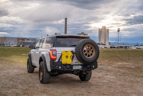

For the rear, a quick solution is a Wilco Offroad Hitchgate.
I've also seen Redtail Overland retrofit an Expedition One rear F-250(?) bumper that's high on my to-do. I think this requires fab work as the frame rail mounts are different between the trucks.

Thank you for the info. That is exactly the type of bumper setup I was looking for. That's a nice rig!
I appreciate your reply
