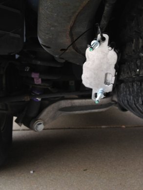

on the right side fuel rail theres a fuel pressure sencor with a vaccum hose atached to it make pop it off and make sure your getting pressure out of it also its kind of a pain on these engines to check pressure but turn the car over a few times and then take the sencor off it should hiss out pretty good
Richard Lewis
Apr 8, 2012
35
Saint Clair Shores, Michigan
sits on the crossmember above the spare tire also if you didnt disconect your battery when you put the pump on you might have tripped the fuel safety shutoff its in the back of the truck if you take out the plastic cup holder or the thing next to it theres a red button try hitting it in it could be tripped its on the left side of the truck

Found it! Thank you for the pictures, thank you everyone for your help, 900$ later, it's running you guys are great
