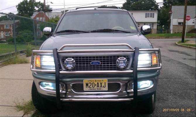

Problem Solved... The previous owner ran the wire from the stock fog switch separately... he also inserted another in-line fuse and it was BLOWN... That was the problem... Switched it and it works perfectly... After all the searching... I'm an electrical pro now! :)
