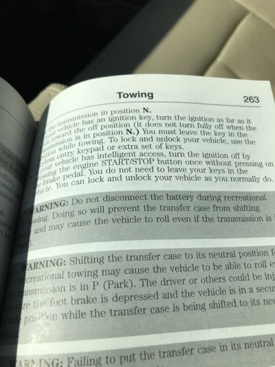

Did you read the towing section in your vehicle owner’s manual?

Yes I did and tried. However because I have no dashboard, and no sound indicating the neutral position is reached (after switch from 2H to 4L 5 times) I can’t tell if the car reached is in neutral or not. Guess I will have to wait for the towing truck and try.
Newbie Question : if the car transmission is engaged is it still possible to load it onto a tow truck?
