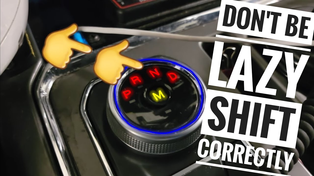

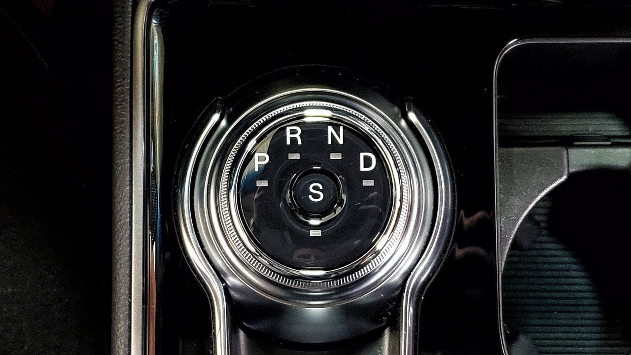

If you have 12volt power you can get the trans into neutral via the dial.

Not mentioned in this latest YouTube video about using the rotary Gear Shift Module (GSM) to enter Stay In Neutral Mode are these cautions offered in the 2022-2024 Expedition Workshop Manual...
"If the battery discharges while in Stay in Neutral Mode, the park lock pawl solenoid releases and transmission returns to P . Do not tow the vehicle in this mode. Neutral Hold exits 30 minutes after the ignition key is turned OFF resulting in transmission returning to P ."
Fuller detail on Stay In Neutral Mode, Automatic Return To Park, and Emergency Tow Mode (Emergency Park Position Release) is contained in the Workshop Manual sections attached below as PDF documents...
Good luck!

Yes, this is correct. This is only to get it onto a tow truck. Vehicle should never be flat towed unless you go under the vehicle and manually force it to remain in neutral and only for emergency use only to get it safely off to the side and out of harms way.
