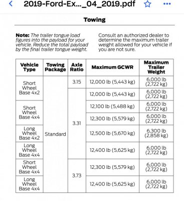

The dealer printed out the spec sheets for me along with the brochure since I was shopping between the HD and non HD package. HD can tow up to 9300 but we settled for the non HD.I have a Crownline 192 BR that weights around 3000 lbs, the trailer is another 1000 lbs.
https://www.brandonford.com/blog/how-much-can-the-2019-ford-expedition-lineup-tow/#:~:text=Without the package, all 2019,6,600 pounds – regardless of drivetrain.
The 2019 manual shows a maximum of 6000 to 6300 lbs for the non-HD tow on page 291.
