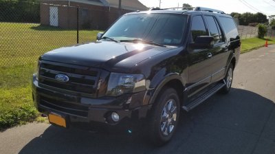

Heere ya go........What a pain in the BEANS.........

Great looking grille.....What was involved with installing it....and is it an insert or a complete grille?

It is just the center peice. I had to take the lights out, remove the radiator cover (no big deal), pull the whole grill out remove the center piece and replace it with the Billet grill. A funny thing was apparently at the factory when they installed the grill the broke the clips on the bottom and had super glued the brokenpieces to the bottom of the grill to hold it in place.
Re-installing the assembly was a serious pain in the beans.....The gril was too big, I had to bend the bottom corners to get it to fit, the pieces that the instructions say to leave on I had to cut off. What should have taken about 1/2 hour took alomost 2 hours...........
But it does look nice.

I have a different problem with my 09 Expy grill. The lower bar sags, looks a bit like a smile.
Look behind the lower bumper cover (that's what it is, not a grille), it's probably not installed correctly...that curved smiley piece is supposed to be pushfastened to some piece directly behind it afair, and tends to bend if it is being pushed aside instead of clicked in place
