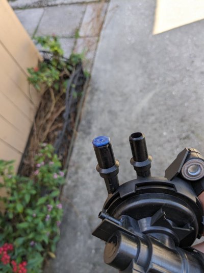

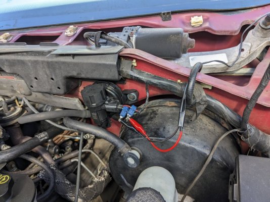

I had a similar problem with my 2003 F150 with the 5.4 engine. I had a P0443 code show up. However the engine would run fine. I cleared the code and it would reappear. I changed the purge valve with a Dorman 911-231. The first two times the truck went into the purge cycle the engine died. The next few times the engine would stumble but recover. It got better and better until it was virtually unnoticeable. I think the computer must have been learning what to set the fuel trim to when it the purge cycle but I'm guessing. I connected my scan tool and saw the short term fuel trim on both banks would jump from less than 5% to around 20%. I connected an LED to the purge valve control wires and hung it in front of the dash so I could see when this was happening. Sure enough the high trim levels corresponded with the purge energized. After reading this post about issues with the Dorman part I compared the internal size of vacuum ports to my Ford part. The internal size of the canister port on the Ford part is much smaller. Of course I didn't discover this until I had leak checked the system and removed the evap canister to inspect it with no problems found. With my newly acquired 3D printer I made a restrictor with a hole diameter of about 0.090 inches that would slip into the purge valve. l used PETG plastic which is fuel resistant. It's the blue part in the pic stuck in the port. With the restrictor installed short term fuel trim stay around 5 or less with purge on or off. Thanks SonicWeaver for your post. It set me on the path to a solution!

Problems with junk new parts seems greater then ever. If you question a new part as I have offten, A visit to pull and pay is in order. Find a wrecked one, I.E. running good when hit, and go parts shopping. Will done.
