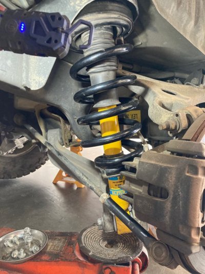

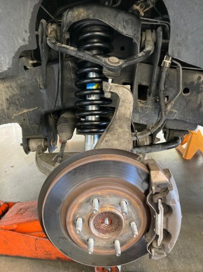

I have a 2004 Exp and am considering installing the Bilstein 5100 or 6112 adjustable-height shocks (made for the F150) on the front of my Exp to improve the suspension off road, and to get about 1 inch lift without using spacers. The Bilstein 5100 does not include new coils, the 6100 does.
The 5100 and 6100 products are not offered for the Exp, but are for the F150. The front suspension for the Exp and F150 is very similar. One diff appears to be the spring rates. I don't know how diff they are, but it doesn't seem like a big deal because the weights of the two vehicles are similar.
Bilstein does offer the 4600 shocks for the Exp and the F150, so comparing the lengths of the 4600 shocks for the two vehicles seems helpful. Bilstein's 4600 info indicates that the compressed and extended lengths of the F150 4x4 shocks are about 1 inch longer than for my Exp. However, the Bilstein 4600 and 5100 products for the F150 2WD are almost exactly the same lengths as the 4600 for the Exp. Based on this, looks like the F150 products will my Exp because they are similar in length, esp the 2WD product.
I have seen a few threads about this, but nothing conclusive. I called Bilstein, but they were not helpful. I considered the Rancho 9000 Quicklift, but have read mixed reviews about them.
So even if it Bilstein's F150 parts bolt onto the Exp no problem, does it improve the off road performance? Or does it just not work well because it is designed for the F150 for some reason? Has anyone done this or know of a forum thread about it? Thanks
