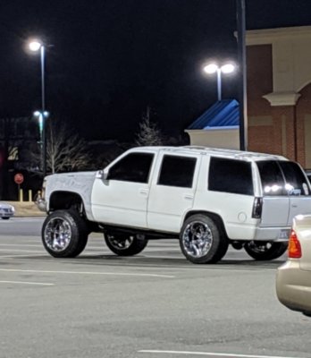

And you’ll be blinding everyone with your headlights

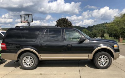

Ok so got the popping straightened out it needed aligned and those grape looking knobs greased up so no more popping but is it me or why does it still look like the front is higher after just a front level kit

I told you this would happen. Sorry you didn’t listen.
“Puts a 2” block up front, nothing in the back, wonders why the front is higher??”

Looks like you bought the front end only of a 4 corners "mild lift & level" kit.
A straight up level-only would be like 1" - 1.25" iirc (hence all the 3/2, 2/1, 2/0.75 etc lift and level spacer or strut kits)

Well shit it said it was a level guess I’ll have to get the rear I posted exactly what I got on the first page it said level. I’ve also looked
At a lot of members that did the 3/2 and the front still looks higher
