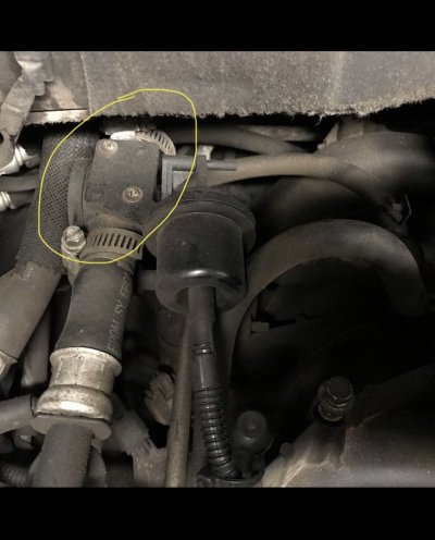

Did you check the heater control valve under the hood? I have an ‘04 that had the valve fail twice. It actually cracked and allowed coolant to leak. However, in your case it may not be actuating; allowing the hot coolant to travel to the heater core. It’s vacuum actuated. Located on the passenger side firewall on my ‘04. See attached pics for location reference…
Just an FYI… myself, and a fellow coworker, fixed a 2009 Titan heating issue. The young lady’s truck that worked with us was suffering from two issues: busted blend mode actuator, and heater control valve. I was able to rotate the arm with my hand. This allowed heated coolant to travel in the cabin. Good luck.

The first-gens don't have that valve, at least none of the ones I've ever seen have had it.

Blisto is correct. The 1st Gen's (97-2002) do not have the heater control valve. They are full time flow on the front core, as well as the back core. But the '03 and later have the front control valve. So the original poster (who did not specify his model year) could have either a frozen heater control valve (if its an '03 a later), or just a clogged front heater core unit (not at all uncommon if a 1st Gen, given that is 18-25 years old now).
