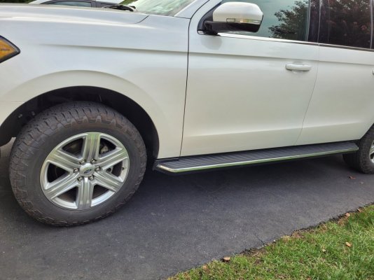

I got the 275/60R20 Cooper Discoverer AT3.
So those are 33". I think I'm going to try 285/75R17 (probably Falken Wildpeak AT3W), which are 33.83". Will probably do +18mm offset wheels. Hopefully this will work!
