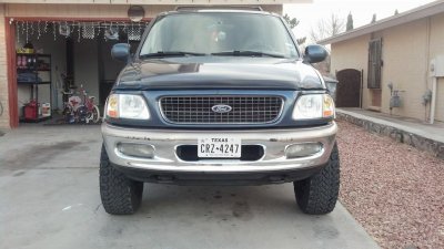

98 EB, just installed 285/70-17s. No issues on the street so far, but I am going to raise the body 2".

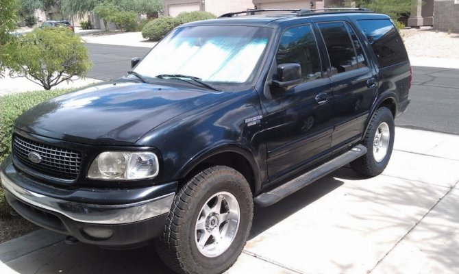

97 EB 4x4: I searched other sites as well, & put 33x12.5x17 procomp at on some bigger procomp wheels, fit without a hitch, driver front tire rubbed at full turn but only in reverse, after years, i trimmed about half inch from lower valence...no rub now...but just to let you know, this was with 4 wheel stock option air bags...once that system broke, i replaced with monroe kit with coil overs up front and springs in back...as the front sat too high I put two " alum spacers on bottom of rear springs...love it
