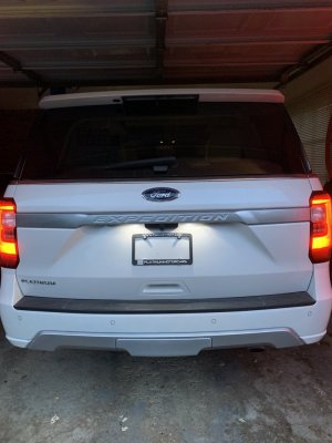

I used these and am happy with color, brightness, and pattern.
VLEDS 2pcs 90lm 6000K White 194 T10 2825 360° Long Life 14 LED Bulb
https://www.amazon.com/dp/B074N7X6G2/ref=cm_sw_r_cp_api_i_Whv-EbVQ0V129
Did the vled - very easy to change.
- press flat head into tabs on right of housings, and slowly pry towards center to start releasing housing from tailgate
- twist wiring connector to separate bulb from housing.
these bulbs aren’t overly bright, and match well to the outdoor flood lighting.
