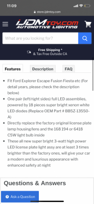

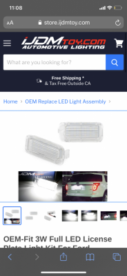

So I bought a set of 194 LED bulbs for my license plate lights and I was NOT impressed with what I got. So I took a look around and found some on ijdmtoy:
18F48EE8-E947-435B-918C-04BF6893682F.png D88CAEB8-0C69-4D66-AD87-01A6854581EA.png
According to the page these replace Ford PN : BB5Z-13550-A. They do not list them as a replacement for the expedition.
I looked up 2019 Expedition License plate light housing parts and found that the PNs are the same.
Has anyone else ever tried these? I think im going to purchase them and give them a try. The LED bulbs just don't seem to spread the light the correct way.

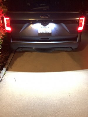

well for anyone who is/was interested, I ordered a similar set off amazon. They work but I did modify them a little.
This is what I ordered:
https://www.amazon.com/gp/product/B07QP3F6KR/ref=ppx_yo_dt_b_asin_title_o00_s00?ie=UTF8&psc=1

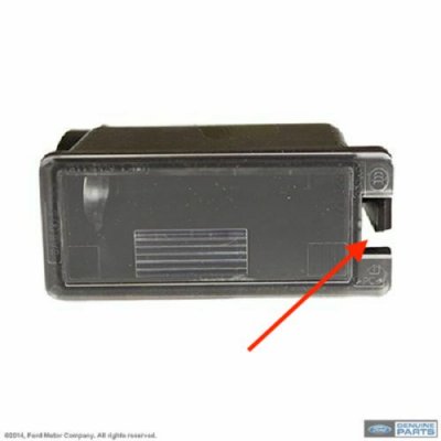

The factory housing has a cutout in it so you can depress the release tab. (see red arrow). The LED ones I purchased did not so I cut out that relief so that if in the future I needed to remove them, for whatever reason, that I could. I will post pictures tonight after the sun goes down. I think these will end up being WAY better than the mis directed LED replacement bulbs I originally ordered.
