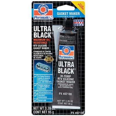

Just a heads up, when you put your valve cover back on, I suggest you use some RTV silicone on the back side of the valve cover, this will help hold the gasket in place when you reinstall, because the gasket will, more then not, hit the last camshaft cap bolts, knocking the gasket out of it's groove and you will end up with a oil leak .
