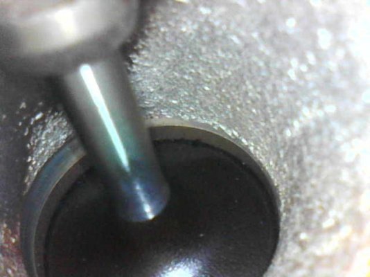

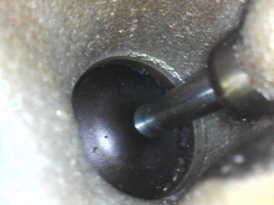

First off, some time ago I reported that cylinders 3 and 4 showed zero leak off pressure, well that was because there was an extra Schrader valve in the line and no pressure was getting to the cylinder - DUH! With that taken care of I got the following data with 50 psi applied (piston was at TDC, any more pressure than that rotated the crank), #1 - 22, #2 - 34, #3 - 13, #4 -15, #5 - 45, #6 - 41, #7 - 22, #8 - 38 - which sort of correlates with the compression test results of before (1/180, 2/200, 3/120, 4/150, 5/210, 6/210, 7,185, 8/200). On all tests the only place I could detect air leaking was from the inlet manifold - but I might go back and repeat that.
I also pulled the intake manifold and put my cheap boroscope into the inlet, all looked remarkably clean (car has ~ 200k miles).
