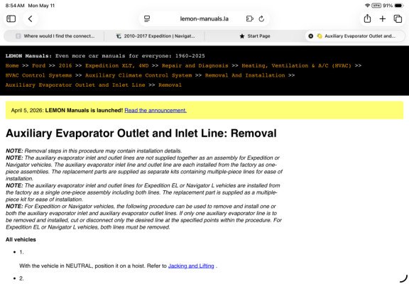

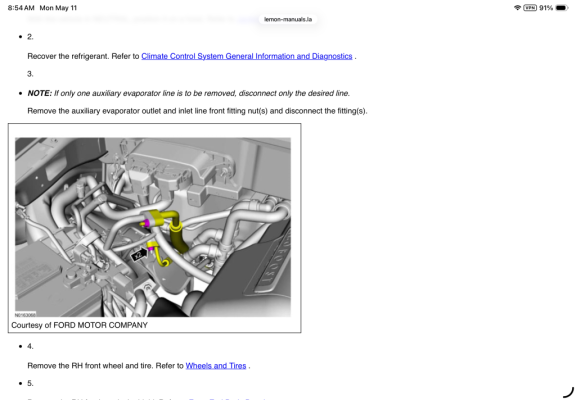

This should get you close. The connections are between the battery and the firewall.
