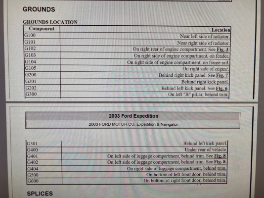

My first thought though was a poor ground, there are a couple grounds under the hood. Now that I have thought it for a minute I'd check the crankshaft position sensor wires and verify the connector is properly seated.
Here's the grounds for my 2004 5.4L, but the grounds are likely the same or very similar.
