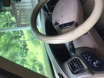

3) steering wheel has some serious wear and tear along with the dash

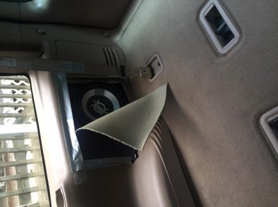

4)most of the speakers are blown

I'm not sure were to find certain OEM parts like the panel for the speakers in the cargo area so homework is needed, I'm not sure how to tell if the motor for the driver seat is bad, every now and again it would move one way then stop other times wont move at all and certain positions wont move period. If that's the case and you are able to ship that I would sincerely appreciate it, if I cannot find a seat replacement because the seat is worn out bad. I'll take pics in a bit to show off the abuse lol smh

there's spray paint for #3
