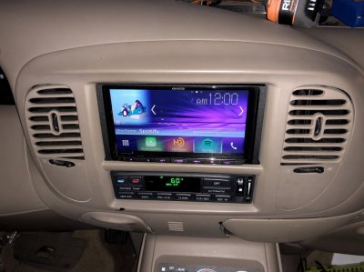

So I have (almost) replaced the entire factory Mach stereo system in my '02 EB.
I replaced the factory head-unit with a Kenwood DMX7704S double DIN head-unit. It includes CarPlay & Android Auto, dual USB ports with high speed charging, thumb-drive support for directly playing music and videos, as well as an A/V input and dual camera inputs (one for rear cam and one for front cam).
I have connected the rear camera and will be connecting a front camera soon. I used an Auto-Vox Cam6 License Plate camera I had purchased for my other vehicle and it works pretty good. Only issue is it's quite easy to bump and mess up the angle.
The headunit has adjustable grid lines so I can customize them how I like.

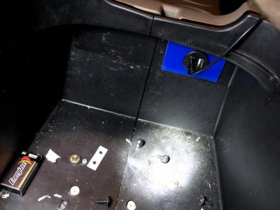

I connected the two USB cables to a 3' flush-mount USB extender mounted in the center console. The flush-mount was just abit too small to properly fit the hole were the CD changer wires used to run to the center console. It was about 1/4" larger than the diameter of the flush-mount so I had to improvise a quick solution, I cut a piece of plexiglass and drilled the correct diameter hole in it and it holds the mount in place. The cupholders just on the other side of the mount put a bit of pressure against the USB cables. While they SHOULD be fine, USB cables don't like being squished at 90° angles. I may revisit this later with a 3D printed piece that holds the ports out a little more, taking some of the pressure off of the cables. I also need to cut a piece of rubber mat for the bottom of the console and maybe install some LEDs for nighttime visibility.

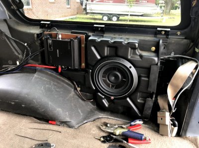

The factory subwoofer surround was dry rotted and the sub amp was blown (fully shorted so it would pop fuses when power was fed to it). I replaced the sub with a Rockford Fosgate P3SD48 P3 Punch Shallow mount 8" DVC 4-Ohm Sub and the sub amp with a Kenwood eXcelon X501-1 Class D Mono Amp. I made an amp mount adapter with a piece of 8mm scrap laminate. It is taller, but narrower than the factory amp and and there is plenty of room for cooling. I can also adjust the crossover and bass boost if I remove the little cup/bin (whatever it is) next to the right rear passenger. The sub sounds OK.. but I would really like to replace the box one day with one properly designed and tuned specifically for this sub. It just bottoms out WAY too often when the volume is up.
