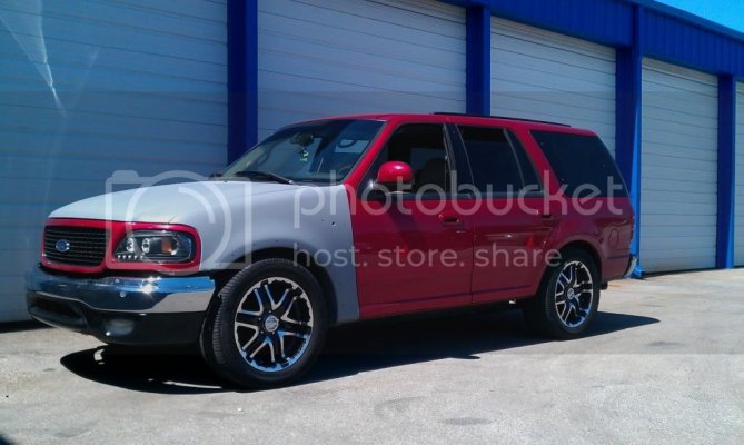

Heres a picture of my expy in process just got the lowering kit done on it today.IMAG0406.jpg
Very nice! I like the two tone look..lol. Do you plan to repaint whole truck?

Yah the whole truck will be going red with black wheel lip molding and and lower molding black
