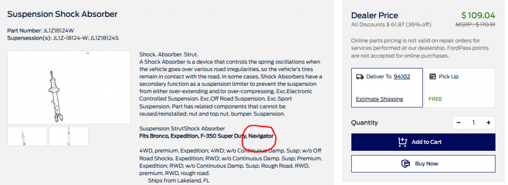

Hello everyone. Just a thought i came across as i am riding in my donkey kicking stealth non CCD (LOL).
I was wondering if the Navigator springs would fit on this truck? I know they are CCD shocks, and that the navigator does have a lower tower rating, but i am thinking that is because the vehicle has a softer spring.
Does anyone know if they would be able to swap over to the expedition?

hmm. im on tasca parts and it looks like they share the same part numbers. Interesting. Must be the tuning as well (of course)
I wonder if anyone here has gone with the springs that are NOT with the HD tow package...

Expedition is at the dealership for another matter, but currently reviewing if they will put non HD towing shocks on. The guy behind the counter didn't seem super confident he could work it out, but asked them to try. Goal: go from HD Tow (Non CCD) to regular shocks (Non CCD)
Will update.
