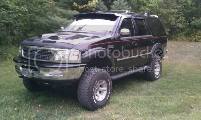

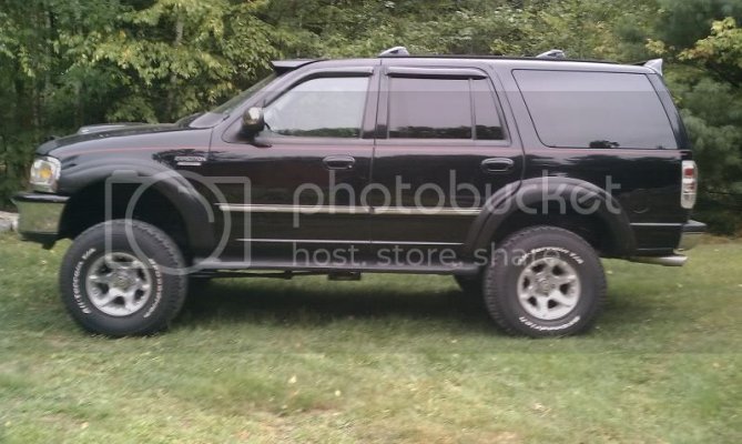

Hi Guys and Girls. Just bought a 97 Expedition. Now what? Lol. I want to paint or replace the chrome grille surround and make it black, install a billet grille insert and see what I can do about the body roll I feel from the back when going around corners and bumps in the road. I have the factory air ride, not sure how it works with the lift kit....
Here's some pics...
Oh, it doesnt have the euro tails on it anymore and I replaced them with stockers. Lol. They are for sale though. ;)

looks good man. how do the BFG's ride? i'm getting the same ones pretty soon. i'm installing a 3" body lift and 2" spacers once they come in the mail.

Thanks Guys. Thebfgs ride real good. There about half worn. Looking for something more aggressive but still DD streetable soon.

Welcome to the forum. Great looking truck.
I just bought a very similar set of fender flares (if not the same ones). I was wondering, if you wouldn't mind, I would really appreciate if you could take some close up pictures of how you have them installed, as I am currently in the process and it has been pretty tricky for me so far.
Also, I just painted my chrome grille this weekend. Not sure how it will hold up, but here is how I did it. Sanded all the chrome with 60 grit and an electric palm-sander. Wiped it down with alcohol and clean cloth. Two coats of clear adhesion promoter (Duplicolor - 1 12 oz can). Two coats of gray hi-build sandable primer (Rustoleum - 1 12 oz can). Three coats of black bumper coating (Duplicolor - 2 12 oz cans).
Good luck with the grille and I'd really appreciate some pics of the fender flares. Thanks.

They were on it when I bought it. Not real sure how they are installed. I an take pics ifyou want, but not sure if it will help.
