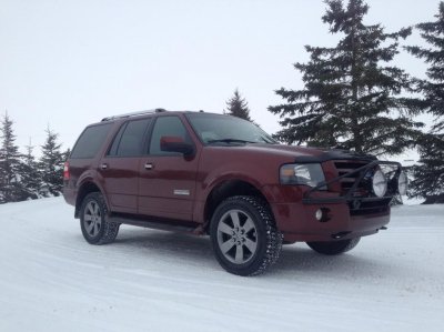

Just installed 3/2 levelling kit on my 07 limited
Did not use the rear spacers just replaced the rod going to the ride height sensor with a longer one to get 2 in lift for the back
