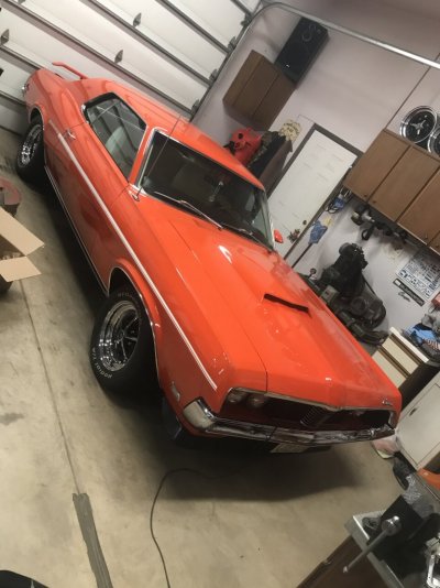

is that a 70 cougar I spy? Drag pak eliminator?
That’s my 69 Eliminator with the 390 4V IP engine. No drag pack option but it does sport factory air conditioning. If the person ordering it checked the A/C option then it came with 3:00 ratio axle and automatic with no other gear/ trans options. The 428 cars got 3:25 ratio only with air and automatic. The irony is that a automatic with air car is worth more than a 4sp car because of no A/C option, but a drag pack car 3:91 ratio or super drag pack with 4:30 will bring premium money. I have two different 9” third members set up that I switch back and forth with, one is a 3:50 Detroit locker, and the other is a 4:11 Full Spool which currently in the car now. I got rid of the 3:00 open dif. right after putting it on the road after I restored it. I could smoke the right rear for eternity before it hooked up. The car had to try and catch the tire! Lol! Sorry for the high jack!2F2082E9-5450-4519-AAC6-8BB230863AC2.jpeg
