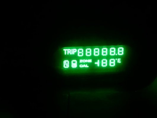

All was well again until we start home. I try to accelerate going up an on ramp to I-35 and lose all power to tires and cab but does not stall. I let off the accelerator, noting the odometer, compass and temp screen is showing "888888888888." A couple seconds later power returns and off we go. Had this happen a couple other times til I got used to being easy with the foot. Wife noted that the symptoms started at 3000 RPM. I also noted that the AC, which to this point has never failed me, began having issues. It didn't seem to be as cold when I got there, which I attributed to the TX summer, but now when set on MAX AC and high fan, the fan speed varies as does the temperature of the air. It was definitely impaired right after the near-stalls. This sometimes seems random but other times varies with the positioning of the windows up v down.
