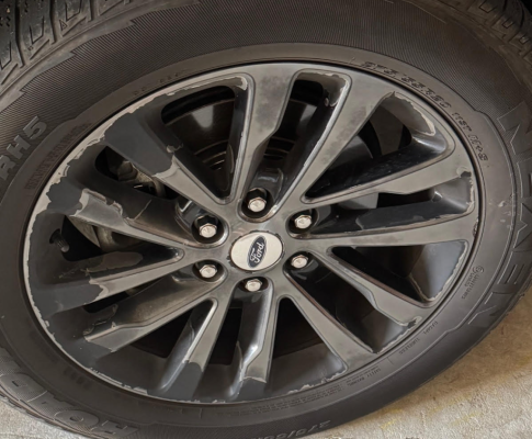

The clearcoat on my OEM wheels is peeling off like burned skin. 3 out of 4 of them!!!!!
These wheels have been babied. I'm the only one who has ever cleaned this vehicle, + no solvents or chem cleaners ever used on these - only water through a garden hose and a soft non-abrasive sponge.
Anyone else having this issue? If so any path to recourse with Ford helping out on refin or anything? 2019 Limited. I have ESP but out of 3/36 of course... the dealerships shrug & say there's nothing they can do.
I have to say, it's a pretty hard pill to swallow, this $75k vehicle @ 4yrs old, with wheels like this, when i take such good care of it.. It's really disappointing. I can say that NONE of my other vehicles have ever peeled like this, even after a decades + (my 23 yr old 2001 audi's wheel finish was mint when i sold it this year, and it never saw a garage in it's 240k mile long life.) I see 10 year old KIA's with better condition wheels. Come on FORD... you can do better. What is it they say - Quality is job 1? end rant.

Yeah, my Limited wheels are trashed… I can’t speak to how previous owner treated them though.

Our 2019 expedition limited has same issue on all wheeels I wonder if I can just remove all the clear coat and paint them

2019 Max 4x4 here. All 4 20" wheels are peeling. Fixing to move to 18" wheels, so that should clean up the issue. There is a shop here (Cincinnati) that specialized in restoring/refinishing wheels. If I were going to keep the 20" wheels on, I would probably get them refinished.

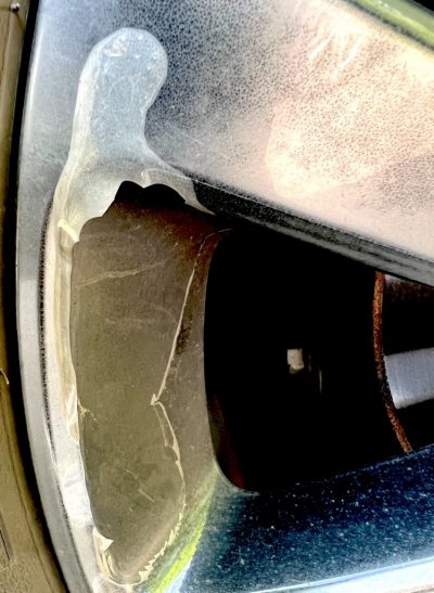

Oh yeah, it's bad. I've been doing some research, Detroit Wheel and Tire specializes in this. I have reached out to them, and these are the options my my 2019 Limited. Does it seem like 2019 has this more than other year models?
https://www.detroitwheelandtire.com...144-pvd-black-chrome-hol-10144-black-pvd.html
https://www.detroitwheelandtire.com...4-pvd-bright-chrome-hol-10144-bright-pvd.html
https://www.detroitwheelandtire.com...144-gloss-black-hol-10144-bbb-gloss-a-ex.html
https://www.detroitwheelandtire.com...144-satin-black-hol-10144-bbb-satin-a-ex.html
They have a unique service, they mail you new ones, put a hold on your card, and you send yours back and they release the deposit. Pricey but they specialize in this. You could probably call around and have it done cheaper. I can't stand Ford doing this, but a lot of manufactures do it. They cheap out, faux chrome, chrome cladding, you name it. Just all around infuriating.
