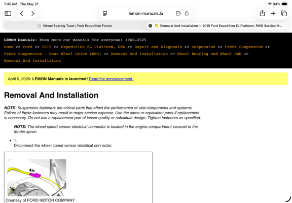

2wd I assume since you are in Dallas. You will probably fight the caliper and brackets more than the bearing assembly. There will be blue locktite on the caliper to knuckle assembly. After the brake is out of the way the four bearing bolts will also have locktite. I reuse the mounting bolts, Ford recommends replacement.
Here is the thread on the front wheel bearing assembly.

Good stuff thanks. Yeah it's 2WD.
It's raining of course. And I don't know whats happening in the wheel bearing market, tarriffs I'm sure, but there isn't an SKF or timken assembly any where in Dallas so the "super cheap" chinese parts are still $300+ each at oreilly, advance, napa, and autozone. That's a little crazy considering perceived quality. Rock auto has Motorcraft for 237 a piece right now. So I'm going to drop a Napa bearing in it when the rain stops and wait for the 2 oem to arrive.
