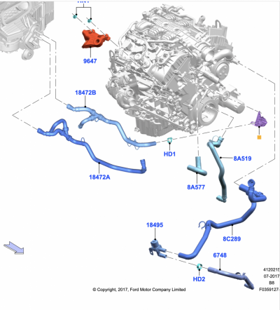

Mine is starting to take long time to warm up... and If I turn on the heat, the temperature will actually drop while driving!
I think that these engines have a heater control valve that directs the coolant to the heater core if heating is needed. May be this valve is stuck open?!!
I think it is part #: JL34-18495-BB (YG857 (18495)): https://parts.ford.com/shop/en/us/climate-control/heater-repair-parts/valve-13291383-1
From the parts diagram, it seems it is easy to be reached without too much effort (see 18495 in the figure below)
