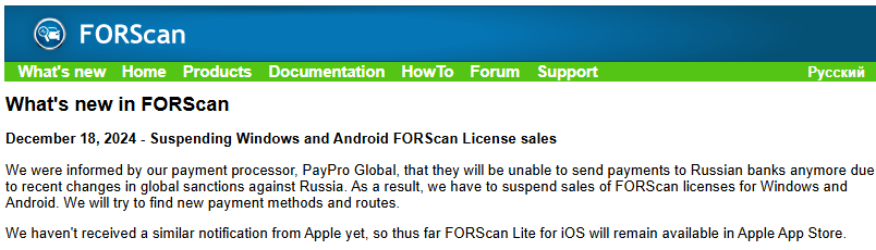

Now I am seeing FORSCAN not available due to recent bank transaction bans to Russia. Is that true?
Joe
I've seen that info posted elsewhere and confirmed on FORSCAN website.
Try the 2 month free trial link below and see if it works for you. Others say it works fine and provides full functionality for a limited time, you can only do it twice, so be ready to tackle the problem when you license.
