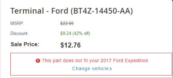

Without getting into the hundreds of things it could possibly be, one thing jumps out at me, because I went down the same road with my 2017.
You talk about the battery terminal being completely corroded and the OEM replacement not being available except as the complete power harness. That is not correct, Ford wants you to think that but they sell the correct terminal and it is shown below, even though it says it does not fit my 2017.
My concern is that in the process of your terminal failing or switching to another type of terminal, the battery management system - a good deal of which is bolted to the positive terminal - was damaged or altered in some way, causing the problem you are experiencing.
Rather than repeating everything I learned by going through the process and reposting all the pictures, I'll just link the thread below, start reading at post number 13.
I'd clear all of the codes and take the truck for a ride to see what, if any come back, and then work with them, seeing if any relate even remotely to the battery management system (not sure I'm using the correct Ford term).
