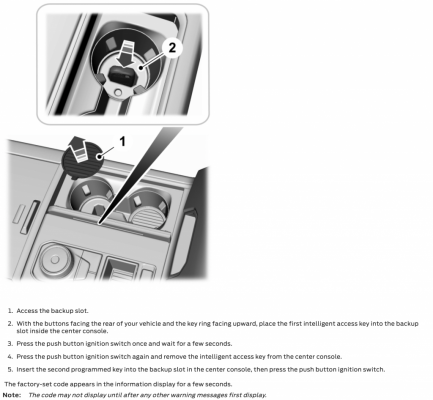

The owner manual says to position the key in the "hidey hole" (as OP called it) with the BUTTONS FORWARD. But it seems to me I have seen this described elsewhere (don't recall where) as opposite. Which is it?

The procedure I just posted for displaying the factory door lock code says to place the fob with buttons facing rearward, and the key ring upward. See Step 2 in the image.
It seems "displaying the factory door lock code" is different, different from just starting the vehicle which is what the OP was trying to do?
This from pg 194 of the owner manual:
