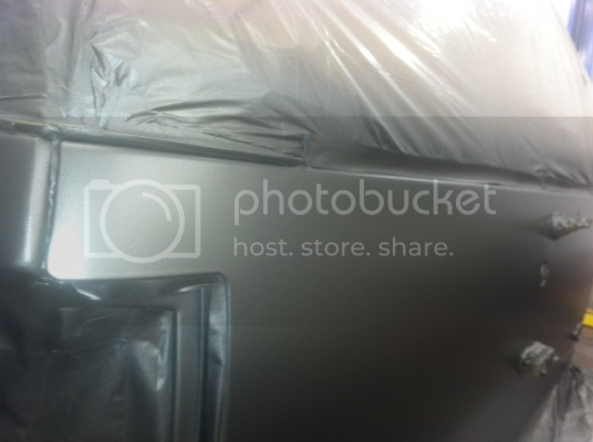

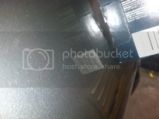

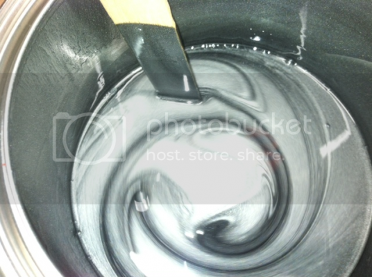

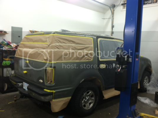

I got it all welded, grinded, putty and primed today. I then went out and bought the rest of the paint for this rocker and the whole exterior. The first time I opened it I thought it wasn't the right color, Looking at it in the can it appears that there is no green in it.
Once it is thinned out and sprayed correctly you can see the green

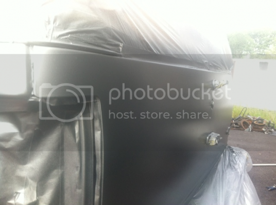

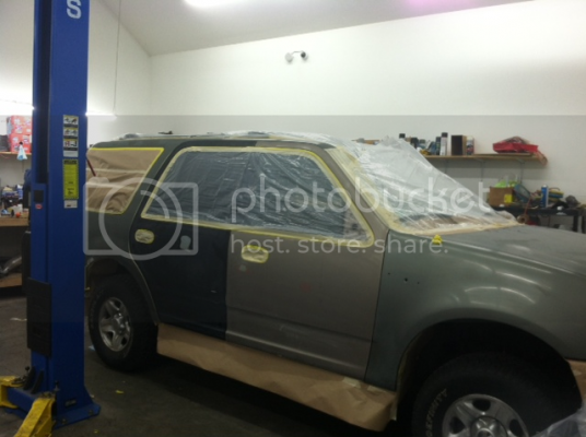

This is how I left it tonight. I will roll it out tomorrow, finish masking the back, check all my masking, wipe it down, then prime paint and clear.

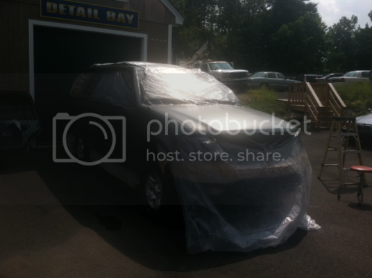

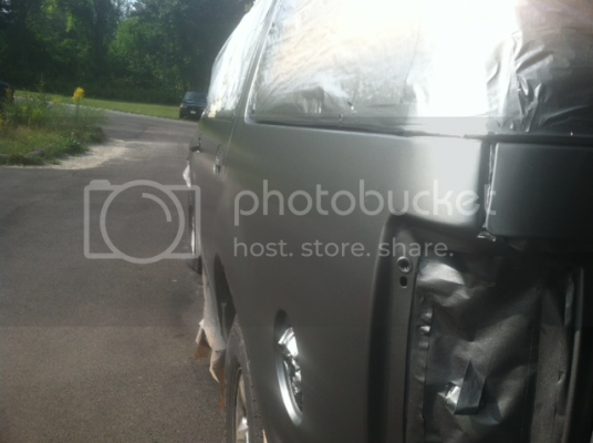

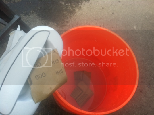

Yesterday I sprayed 3 coats of primer and let it dry overnight. Today I came in and wetsanded the truck using 600 and 800 grit.

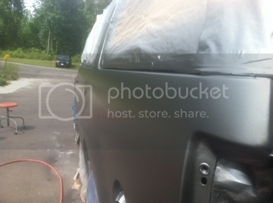

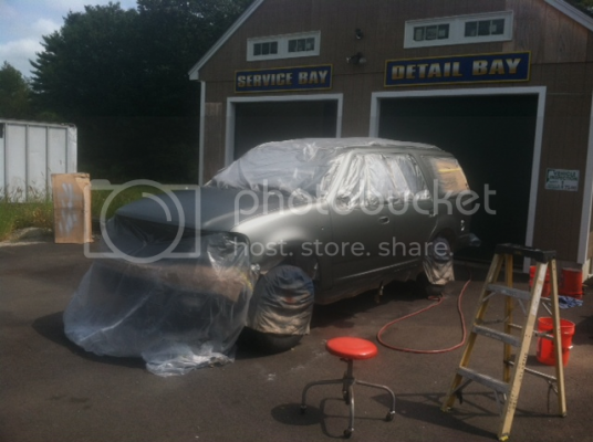

Wiped it all down, made sure it was dry and layed down my first color coat.

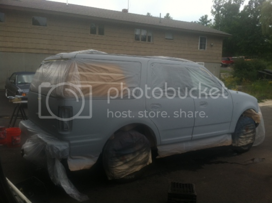

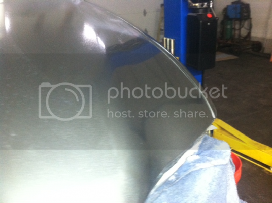

Then 3 coats of clear. There definately is ornage peel so tomorrow I will wetsand it and buff and see what happens

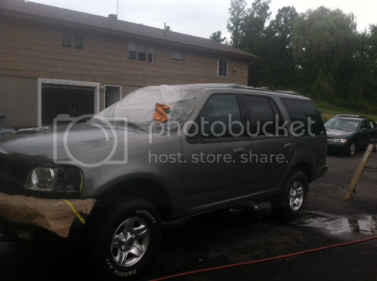

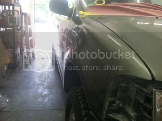

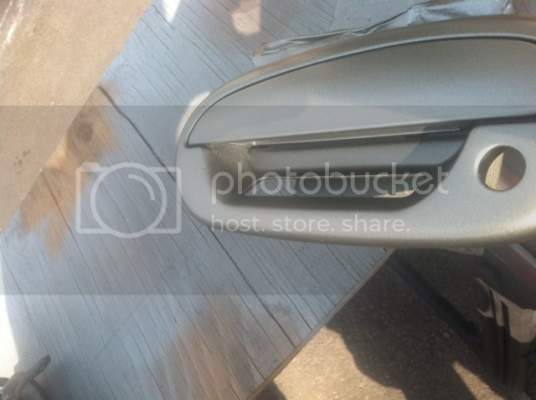

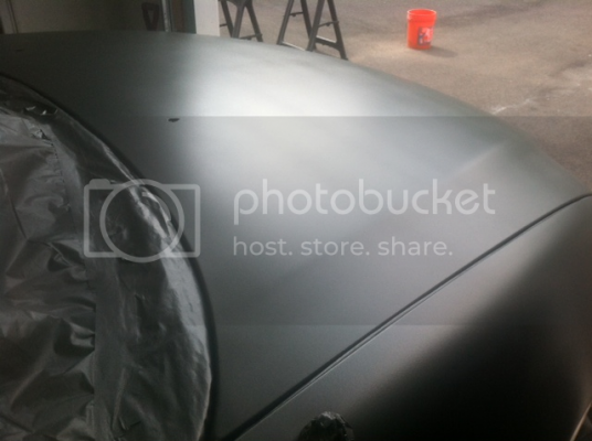

Raining today and in order to wetsand it I would like to keep the hose running a bit to stay lubricated, I am not working out in the rain. I did try and wetsand a few section and buff them out...
Upper roof...

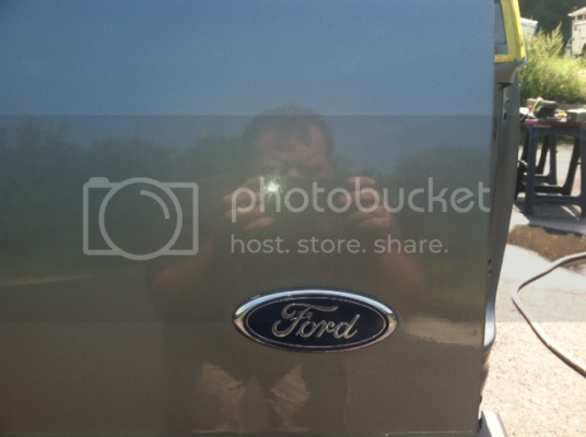

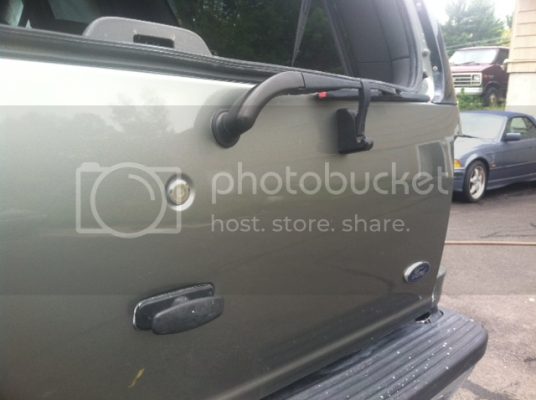

So today was raing alot less, I was able to test a few spots and decided with so much orange peel I was going to have to start with 600 then to 800 then to 1000 grit paper all while wet then buff and polish. This is a huge vehicle to have to do all that sanding but it is what it is.
Started out by buffing the tailgate to see how it will look

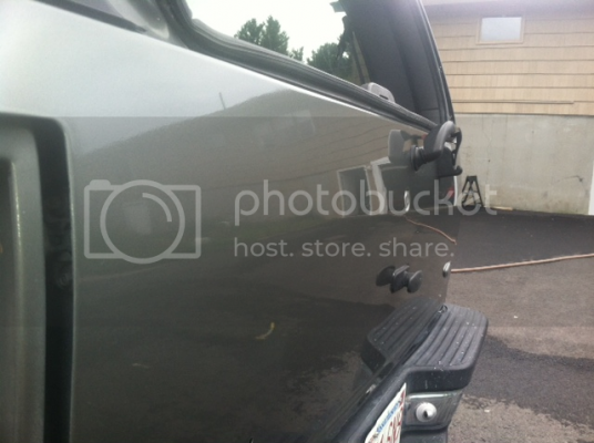

When I came in today I looked at the few spots that I buffed yesterday and after buffing cars as well as wetsanding for 26 years I knew I could get it a little better. So I started all over again at 600, then 800 the 1000 then 1500, all by hand and took my time.
All wetsanded again
I started to buff the passengers side with 3M rubbing compound and a wool pad, then I will follow with Meg's M105 and 205 on a foam pad.

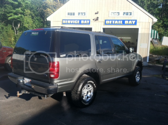

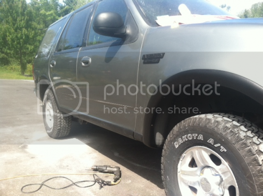

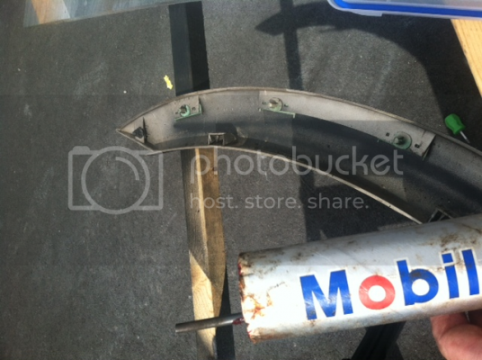

Today I buffed it out again, first time with 3M Rubbing compound on a wool pad, then Meg's M105 with a med foam pad, then Meg's M205 with a fine foam pad. I got it to look the best I think it can with cards I am dealt with so to speak. Then I got to mounting all the Eddie Bauer trim. The parts along the bottom of the doors are held on with double sided tape while the wheel arches are held on with clips that go into holes that are drilled in the fender and quarter around each arch. I put all the clips into the trim piece and then dabbed a bit of grease on the tip of the clip held it up to the truck and where the tips made spots on the truck with the grease is where I drilled. All in all it came out well. The arches are also held in with screws that go up vertaically into the lip of the body.
You can see in the pics behind the rear wheel and along the door where the edge horizontally I went through the paint with my sanding- the orange peel was bad- I think I will tape it off and do a very light mist coat and follow it up with a bit of clear and sand and buff to blend it the best I can.

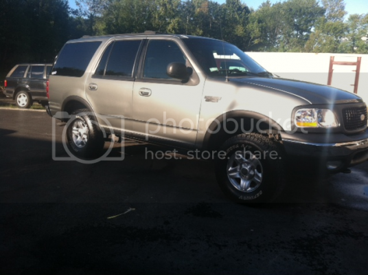

Got all the trim on, washed it truck, did the windows and took off some overspray the made it's way under the tape and paper, dressed the tires and here it is
There are a few small odds and end I am going to do like put a new grill in that will be painted the same as body color, not black. A small 3" body lift or at least coil spacers and torsion bar twist and slightly larger wheel/tire combo, again, all on a budget.
