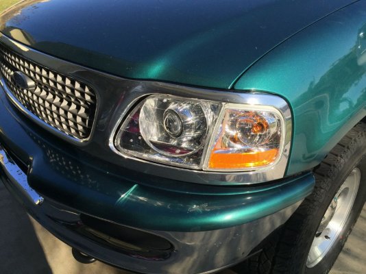

Okay, I have the projectors in and the light output is night and day difference. The projectors and shrouds ended up being too big for the lenses but the projectors ended up fitting. The shrouds needed heavy trimming on the inside so they would slide further back to allow the lens to go on the reflector. I also had to trim the pass through holes on each side of the trucks header so the bulb connector would go through and another two cuts were made to allow the light to be aimed up properly.
My only complaint on my order is that I ordered 5500k as it looked white online but they are blueish in person . Oh well. Pictures to follow later today

On the picture you posted, it looked like it didnt touch at all. If you do end up doing the write up please lmk.

what projector and shroud are you using? my lens touched just barely, maybe the size of a large pen point if that i remember heating the housings to 290 or so to help make that lens flex some so that the butyl glue would hold. I didn't get any pics today since my ADD kicked in and I ended up super focused on getting the projectors into my Taurus headlights. I did look at what I did though. inside of the shroud I bored the inner part out in a way that made the projector sit deeper into the shroud, this backed the shroud off of the lens so that I could close the headlight. it took me about 8 to 12 cuts to get it. you can see in this picture around the projector lens there seems to be a black ring. this was not visible before I cut the shroud back and as far as moving the projector back, you have very limited potions that might get you a couple mm shorter.

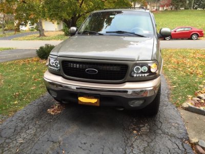

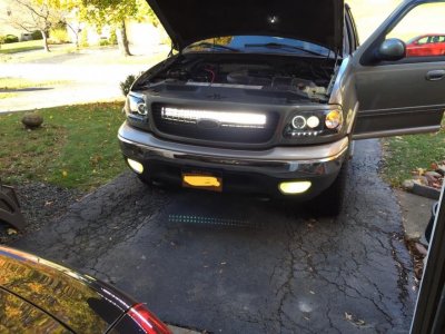

I’d been meaning to address this on my Expy for quite some time now. A couple years ago, I picked up a cheap set of clear lenses from Amazon but they didn’t really help much with light output, and have been difficult to get aimed properly.
I finally pulled the trigger on a new set of lamps about a month ago. I went with Anzio for about $335. (http://www.amazon.com/gp/product/B0038AZMU2?psc=1&redirect=true&ref_=oh_aui_detailpage_o02_s01) These look decent, put out reasonable light with halogens, better with cheap HIDs, but the metal casing that holds the adjustment bracket in broke in several places right away. I ended up returning these.
Decided to give this another shot and went for a cheaper ($142) pair of Spyder lenses. (http://www.amazon.com/gp/product/B0170TMB8W?psc=1&redirect=true&ref_=oh_aui_detailpage_o01_s00) These were cheaper due to LED Halos. These broke in the same way. The problem seems to be that the metal quality is garbage on the casing. It sort of crumbles into dust.
Went for one more figuring I would be careful this time and I was only interested in a set that had CCFL halos. I got the same as above but with the CCFLs. ($220) (http://www.amazon.com/gp/product/B004W4OR40?psc=1&redirect=true&ref_=oh_aui_detailpage_o00_s00) These are still on the truck. I was able to reinforce them a bit before install. Ufortunately, the projectors on these are somehow screwed up. They’re putting out all kinds of streaks. I put in a set of HIDs and while better they’re still not right. Pretty sure I will be returning these and doing the retrofit you guys are doing in this thread.
