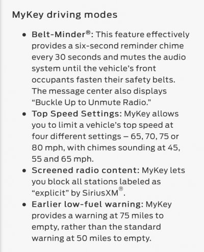

You can set up the MyKey to give you speed warnings in addition to top speed warnings; I wonder if that’s your issue.

hmmm. thats a good thought. The other idea is it could be lane keep assist as it does not initiate until 40mph. it is very faint and obviously a malfunction.
